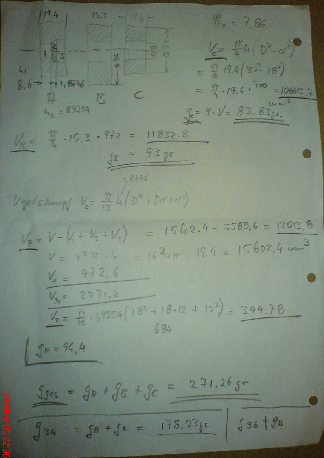

Hello Garnet,
still calculating.....
I want to have my crankshaft balanced staticly AND dynamically - so i have
to to some maths in order to avoid the disassembly of my non-concentric
crankpin from the 2nd crank (flywheel side).
But actually in progress - look here (K750i):
Greetings - Thomas
